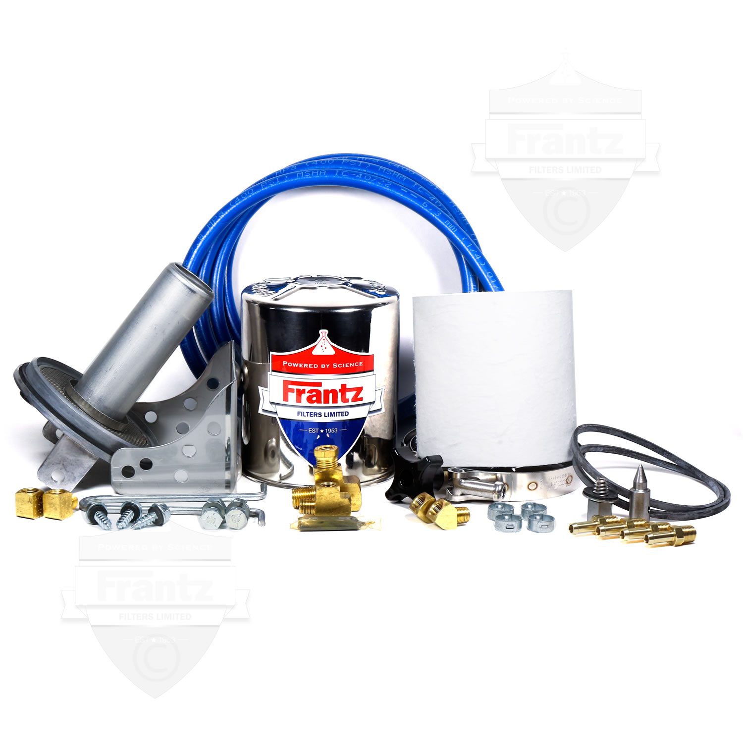

I have a Chromed metal Frantz Oil Cleaner/Filter one (see below) that suits remote inline mounting (like an oil cooler does) that I have never used, but thought as they originated in the 1960's or earlier they were surpassed by later finer micron screening in quality disposable filters.
Looks like they are still around since 1953 and claim to be better than modern ones (as they would) with a 100,000 mile change interval with full synthetic oil:
haven't they heard of oxidation! That may suit a diesel truck engine that is rarely turned off and could do that mileage in a year - BUT for a bike!!!!

Frantz Filters, LLC. Official Website
Q&A
Can't I still use any brand or type of TP for my Frantz Oil Cleaner/Filter?
Most toilet rolls are no longer suitable because they are wound too loosely or are embossed resulting in poor filtration. For optimal performance of the Frantz oil cleaner/filter we recommend buying Frantz replacement elements which are specifically manfactured to achieve the best filtration.
What is the filter element made of?
The Frantz Filter element is made from a special grade of cellulose fibre and is densely compacted to provide effective sub-micron filtration.

Frantz Filter Universal 30K Kit
Universal Kit - Frantz Filters Official Website
Frantz Filter Universal 50K Kit now US$360
Frantz Filter Universal 50K Kit - Frantz Filters Official Website
This Frantz Filter kit comes with a Quart of Hot Shot’s Secret TBN Booster to replenish detergents. This kit provides an extended drain interval of 50,000 miles.
The chart shown, is a result of a 3rd party oil analysis conducted by Blackstone Laboratories. These numbers come from a 6.0 L Powerstroke F-350 with over 215,000 miles.
The initial sample was drawn from the dirty motor oil that had been run for 4,711 miles, and was close to its next scheduled oil change. The test revealed 41,182 contaminating particles at 2 microns in just this small sample.
The next sample was drawn from the same dirty oil (without being changed) after adding a Frantz Filter for just 200 miles. This test revealed just 1,641 contaminating particles at 2 microns. That is a 96% decrease in contamination after just 200 miles!
The final sample taken was from brand new Shell Rotella Motor Oil, which revealed 1,818 contaminating particles at 2 microns. When comparing the analysis of running dirty oil through the Frantz Filter for 200 miles to the analysis of brand new oil, it is evident that the Frantz Filter keeps your oil analytically cleaner than brand new oil.
Frantz Filter Universal 100K Kit now US$380
Frantz Filter Universal 100K Kit - Frantz Filters Official Website
Please note that this Frantz Filter kit comes with one gallon of Blue Diamond Synthetic oil and a Quart of Hot Shot’s Secret TBN Booster. Additional gallons of Blue Diamond can be added to the cart, if you’re unsure of your oil capacity feel free to call us at 1-800-341-6516 and we can assist you. This kit provides an extended drain interval of 100,000 miles.
