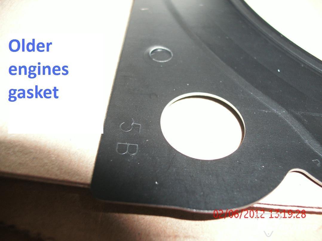

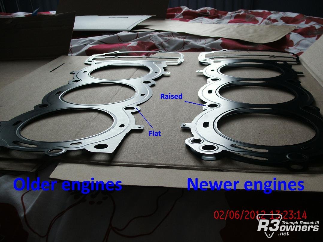

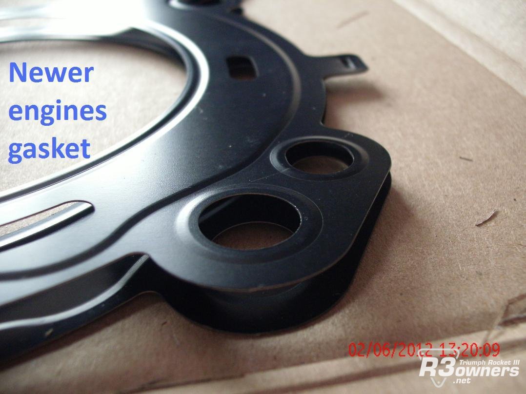

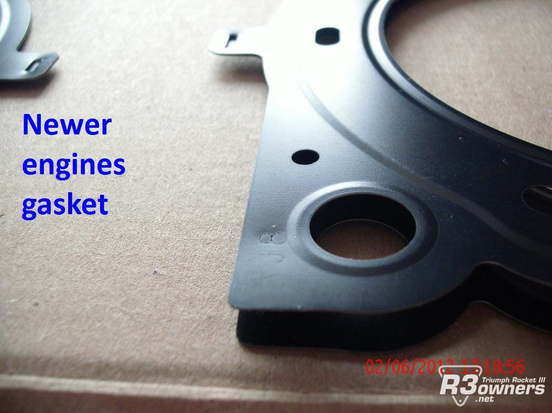

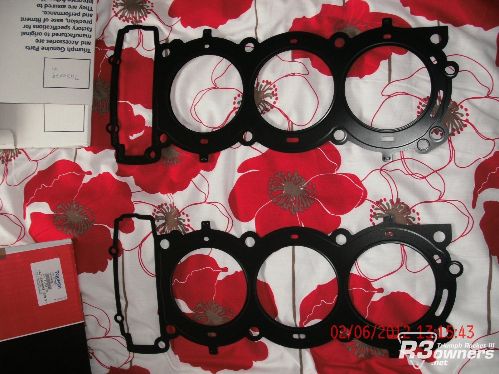

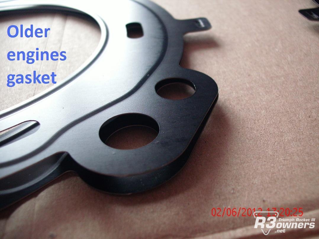

Re "I failed to note what the engine # the change was."
I THINK all the Triumph part's listing references to Engine numbers for specific parts are actually referring to the last 6 digits of your VIN. Engine numbers do not match and are different. Any confirmation?
Yep
T1151150 was early > engine No. 254213
Came as part of Complete Full engine gasket kit T3990089 and Head gasket kit T3990092
T1150189 engine No.254214 >
Came as part of Complete Full engine gasket kit T3990093 and Head gasket kit T3990092
