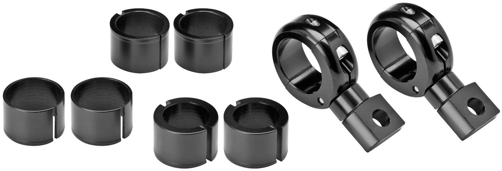

The next trick is to mount the buggers. And for that I'm getting these:
They grip onto the crash bars and I can mount the horns to them. Should be able to get them in pretty snug to the engine in behind the radiator. Once I have it all installed I'll post pics of it.
I used those mounts to mount my horn on the crash bars, they worked great!
