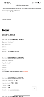

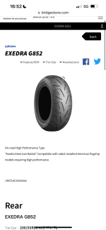

I think this exedra 852 might be better for you journeyman as you run hard at times, i have found is softer than exedra max, handles better in my opinion and it will not last as long as the harder, made for putting down miles cruising exedra max, the 852 is for crushing it. It comes from battle ax racing line, same tech they claim.i had told you about this tire on a run and not sure i sent it to you.

I'll check it, but can't imagine anything wearing even faster (softer) - although the Exedra Max wears as long, or longer, than the cool branded Cobras.
Maybe a little better wear than the cobra which i like
Over hyped, in my opinion- the Cobras... They wear funny too...
Has anybody actually run an 852 on a Gen 2 rocket? I'd be curious to hear how it handles/grips compared to the Avon or the Maxx. I also just noticed that Revzilla is showing a new tire available in 240/50R16 which is the Metzeler Cruisetec. It's a dual-compound tire which I don't think any of the previously discussed tires actually are. Anybody have experience with the Cruisetec?
