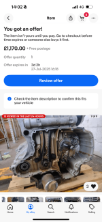

One final question, the engine casing on the new engine is missing, can I use the one from mine, ie will the bolts be in the same place
Yeah it'll go alright. Clutch too coz that's missing from the silver engine!
The camchain guides were updated a couple times since those too but that's something to consider, not quite as necessity
