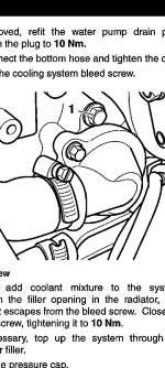

Hey! Where is the bleed screw. I have the manual and it shows it just above the water pump drain plug, but mine is not there?????
Thanks …. Den
Its next to the thermostat. #1 Here is the thermostat upper left side of engine.

There is an old thread from August 17 2017 by member "Wrecka" titled "Coolant bleed screw" that has a pic of the bleed screw which is just above the thermostat, located where the upper radiator hose attaches to the engine.
