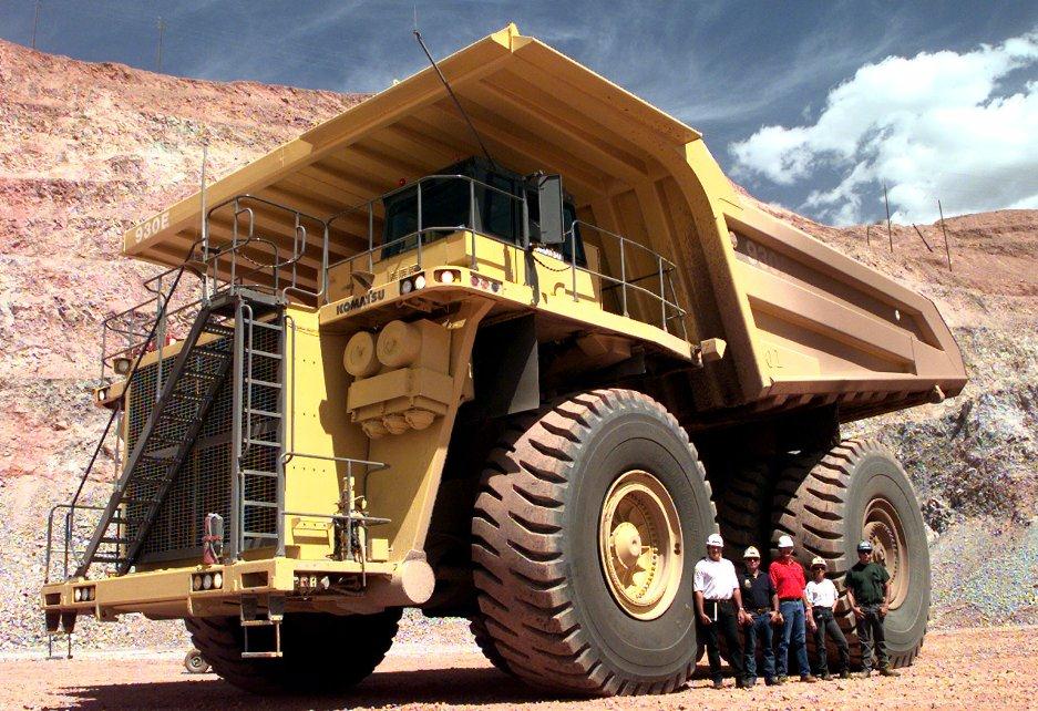

In other words , they belong on one of these...
...and you maniacs are running them on the equivalent of one of these...
images
I hope that opposing motorists have their welder's goggles handy when they encounter you bananas!
