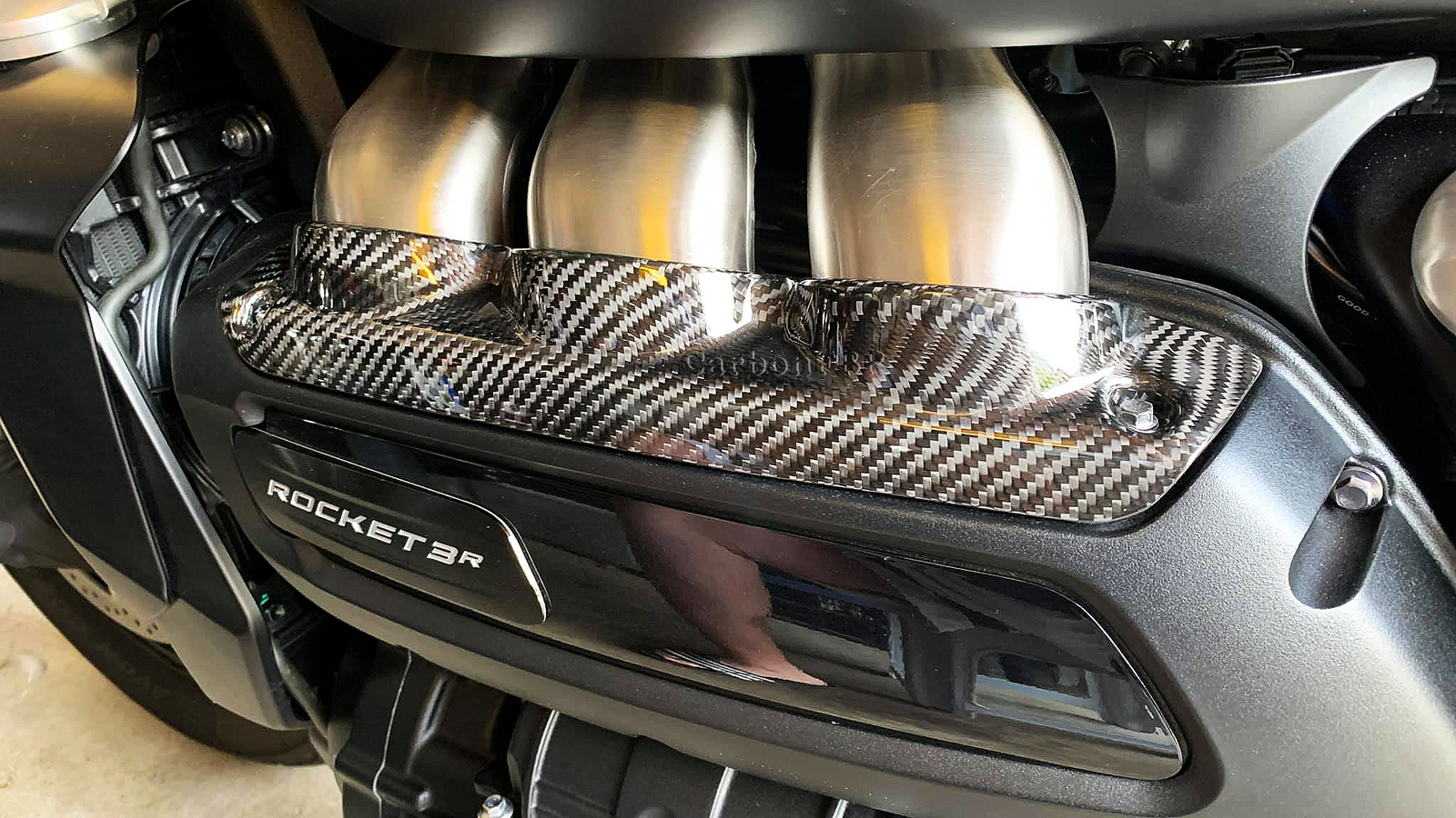

Received my carbon exhaust heat guards today from Carbon FBR here in the UK, quite a wait but I think it was worth it. Comes with heat reflecting foil on the inside and heat resistant washers. I have a plenum cover on order but that will not arrive until October :(
I'm rushing it as fast as I can. The heat shields and plenum covers are going out faster than I can get them in. I should have it faster than advertised but I don't want to make promises I can't keep so keep the the factory ETAs
