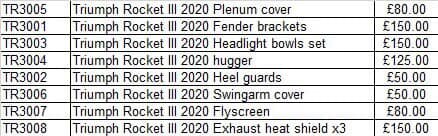

I found this Carbon fiber dealer for R3 from England much cheaper than any other location that I have seen. I'll be placing my order soon.
I put the same up yesterday, the bloke seems decent to deal with, just a bit of a lead time for non stocked items..
A company in Germany
KR Techno is from Belgium, i´ve taken a closer look to their parts they made and i´m waiting for a company which makes carbon fibre parts in german quality.. KR Techno is overpriced for the quality they deliver to the customer imho.
