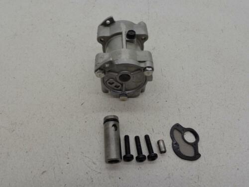

The oil pumps are fairly common on Pinwall and if from a crash victim could be a better option than a used one from a engine with metal bits floating around like my Project Toads engine, so I bought one a few years ago but it was the twin rotor.
#6 on Image
Oil Pump, Twin Rotor T1210002
Your broken shafted one is the
#1 on image
Oil Pump T1210092

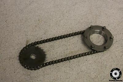

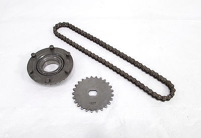

Looks like just the front oil pump chain and sprocket.
Twin rotor same as my spare
