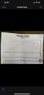

I have a air fuel run with the DNK tune let me see if I can find it. Does this look lean? Before and after tune.
Why is it so high below 4000 rpm?
