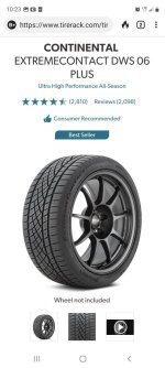

I saw a continental extremecontact DWS 06 plus 225/50RZ/16 That looks good. What do you think?
