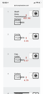

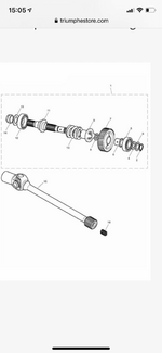

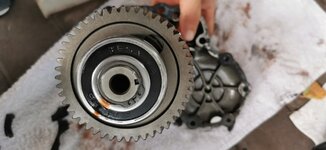

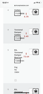

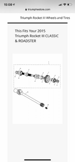

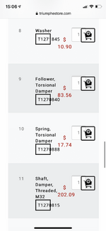

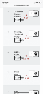

Hi, can anyone help me with part numbers for the updated bearings for my torsional shaft?

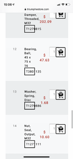

Yup, change the oil seal why youre in there id suggest, also new circlip, verify at hermys for your bike, mine is a touring, if you have a roadster they have a bearing kit, you have to verify for your bike,
