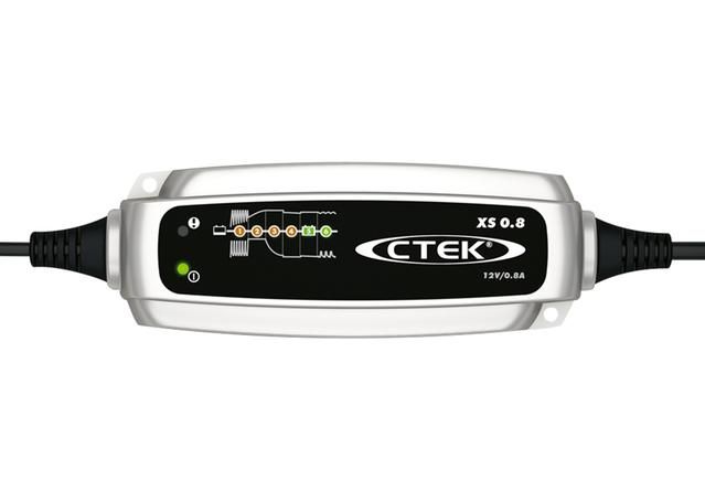

I just use on of these battery chargers, hope it’s the right one 😱
