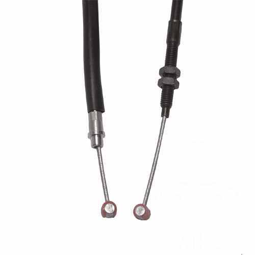

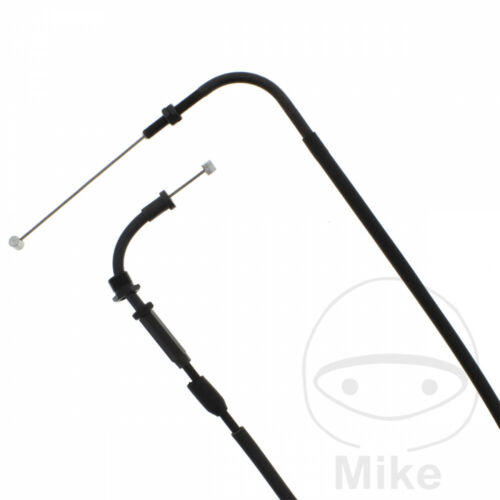

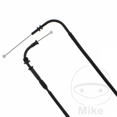

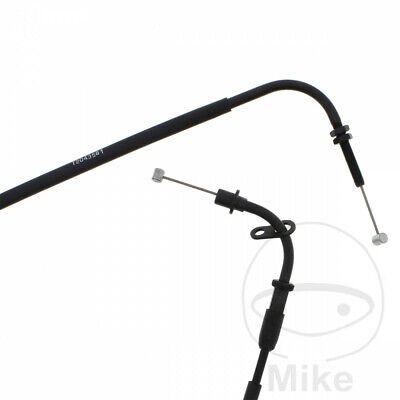

Rocket III clutch and dual pull/push throttle cables.

The Classic and early 04-08 cables will fit the levers and end mounting points/connections of the Roadster and the Classic ones may be slightly longer from comments /posts in old threads as they came with floorboards and pull back bars requiring extra length. I have not compared mounting points for the R3Touring but they are likely different at bar end despite being longer than Roadsters for similar reasons to Classic but likely different connections.
