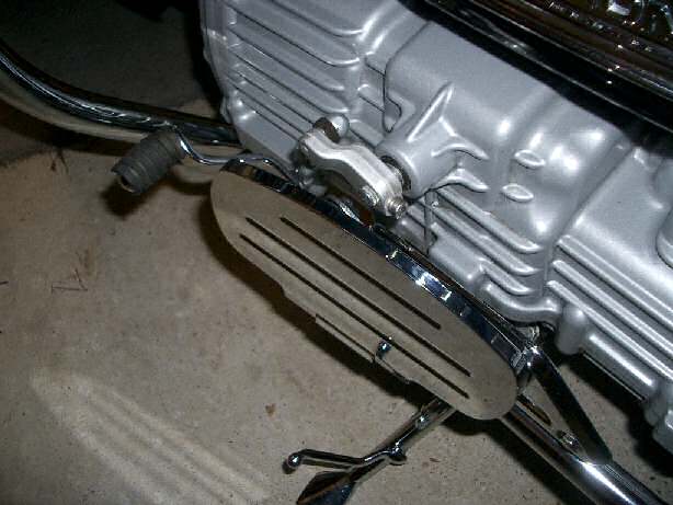

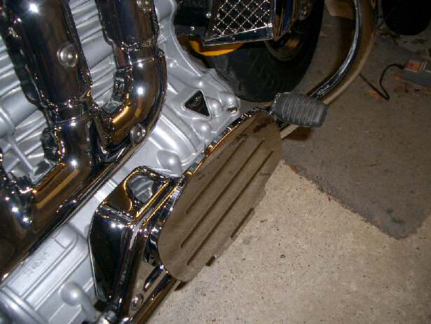

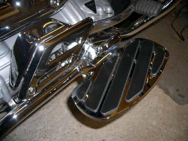

I still have the switchblades with the modified adaptors, if someone wants to try them. I switched to Triumph footboards. The switchblades gave about the same clearance as original pegs, but if you scraped when in closed position they would open up on their own--which was not really a problem. They act as mini floorboards and reposition your feet back when opened. see below......
Holy Cow, I had no idea what I was looking at. Very cool and excellent pics. I have looked at the RAASK rear sets but nothing else in detail. I had never seen the 'switch blades' before. I can see where those would be very nice on a long ride and fold up for a twistie. I like that. Thanks for the pics.
