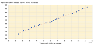

Please see attached my oil consumption with is a bit higher than 1 quarter per 3 thousands miles. I never had this with any previous bike or car. (Sometimes the Rocket generates a blue smoke when I start the bike with cold engine).
Asking about to Triumph through my dealership (who sold and did the maintenance to my previous R3 2.3), Triumph will not do anything as they consider that the engine could need as far as 1.7 quarter per 1 000 miles ! I will not add any comment about that as I am French and it could be considered as English bashing.
