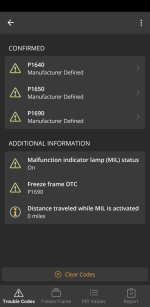

Got the bike started the other day just to load it onto a trailer, and I was able to get my BT dongle connected to read the error codes. Took a screenshot (attached below) and was quick enough this time. First step will be checking for loose wires like everyone’s suggested. Almost done moving, supposed to wrap it up tomorrow so hopefully I can really dig into it next weekend.
Edit: Got tuneecu to work and it had those 3 plus a p16a1 code
