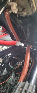

Firesleeve installed. What a PITA this stuff is to work with. I strongly question the necessity of it, Started and checked for leaks, all good. I bought the steel band clamp OEM style clamps and tool, hate them, but they are pretty secure.
