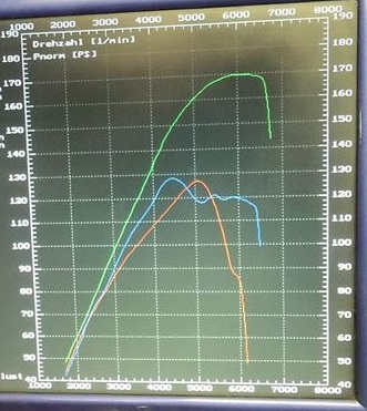

Penner Supercharged Joined Nov 2, 2014 Messages 340 Location Germany Ride Honda Helix Kawasaki W800 Mar 20, 2017 #1 2015 Rocket Roadster Fifth gear Red ist stock Blue is how it came with TORs, Ramair and a lousy map Yellow/green plus crossover pipe and a map Prost Ulf
blip Supercharged Joined Apr 22, 2015 Messages 209 Location Ottawa, Ontario Ride 2014 R3 Roadster Mar 20, 2017 #2 Penner said: 2015 Rocket Roadster Fifth gear Red ist stock Blue is how it came with TORs, Ramair and a lousy map Yellow/green plus crossover pipe and a map Prost Ulf Click to expand... Nice power gain
Claviger Aspiring Student Joined Jul 25, 2014 Messages 6,934 Location Olympia Washington Ride '21 Z H2, '14 R3R, '02 Daytona 955i Mar 21, 2017 #3 curve and gains look just like they should.
Nat67 Rockgoblin Joined Jun 9, 2016 Messages 4,587 Location Dartmoor England Ride Rocket 3 2010 roadster Mar 21, 2017 #4 What tune did you use to achieve this ?
Penner Supercharged Joined Nov 2, 2014 Messages 340 Location Germany Ride Honda Helix Kawasaki W800 Mar 21, 2017 #5 The tune is made just for this configuration.
Nat67 Rockgoblin Joined Jun 9, 2016 Messages 4,587 Location Dartmoor England Ride Rocket 3 2010 roadster Mar 21, 2017 #6 Penner said: The tune is made just for this configuration. Click to expand... Did the dyno tuner write the map or was it an existing tune via tune ECU or a HansO tune ? Interested as most dyno tuners will only tune via power commander .
Penner Supercharged Joined Nov 2, 2014 Messages 340 Location Germany Ride Honda Helix Kawasaki W800 Mar 22, 2017 #7 I used Tune ECU to write the map. PC5 with Autotune is a good help.
Nat67 Rockgoblin Joined Jun 9, 2016 Messages 4,587 Location Dartmoor England Ride Rocket 3 2010 roadster Mar 22, 2017 #8 Penner said: I used Tune ECU to write the map. PC5 with Autotune is a good help. Click to expand... Thanks mate . Good numbers !
Wannbe Supercharged Joined Apr 20, 2014 Messages 378 Location Addison Alabama Ride 2014 R3R Mar 22, 2017 #9 That's a huge gain adding the crossover and map. Was the map that bad or did the crossover help that much?
Claviger Aspiring Student Joined Jul 25, 2014 Messages 6,934 Location Olympia Washington Ride '21 Z H2, '14 R3R, '02 Daytona 955i Mar 22, 2017 #10 The map is most of the gain up top, why it's smooth up there. The crossover will be a small part of that.
