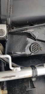

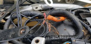

I invited a friend that lives nearby to ride motorcycles and borrowed him my crf for this ride. In preparation I rode that bike the day before to test everything and found that blinkers, horn, brake light, wasn't working. Later on found thre chewed wire, then the burned fuse , the hole in the airbox, the nest and the culprit, A little mice that went riding with me before. I fixed wire, replaced fuse, removed the nest and the mice, then covered the hole to the airbox with duck tape and mesh.
Mothballs everywhere now and mouse repellent but the metal shed its not mice proof.
I didn't notice any impact in performance for the crf after adding that mesh.
