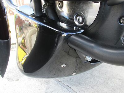

Careful, there are two or more versions of this belly pan pattern from a few makers both with and without cutouts for stock R3 crash bars. I have seen folks buy the untrimmed version and then find it doesn't fit with their stock crash bars.
Some also come with brackets but are not pre-drilled or with clear 'dimples' where they should go.
Others like @Stillserving are not pre-drilled either but do have 'dimples' marking the hole location.
Then there are the predrilled ones with brackets.
We both have fibermans and gary and mad dog

Good looking out, but as @CrzystghndKC stated we have the exact same ones we bought from Fiberman during his black Friday sale. That's also why I made sure to put that in the original post so as to make sure anyone following this would hopefully see exactly what I'm using.
I'll get you some closer if you want but on a Roadster it fit like a glove. Oh I have an 05 that the Fehling bars are on and I'm not putting a belly pan on it.
If you could get closer ones at some time so I can see in detail the spacing as it would fit on a "regular" setup. I'm trying to either match that or decide if I want to move it around a little.

These ARE cutout for the Fehling German bars already! 38mm actually not 35 mm as stated in listing.

Good job! I may have to copy you. I have Fehling bars on now and the bellypan versions made for crash bars was only for the stock factory bars with different mounts/shape. Not sure I want to cut my painted Black Red stripe one though. I have another plain one with the stock bar cutouts too that I may modify or just swap back to the Triumph bar version..
