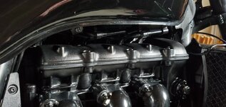

Thanks man I appreciate the help I'm elbow deep in it now lol
Looks like you're through the most tedious parts already. Nice.

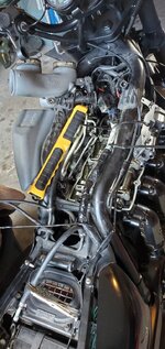

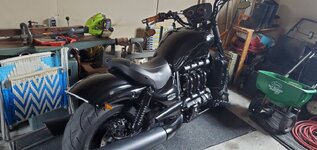

All good thanks again for the help. Went for a rid this morning no more leaks just in time to put it away for the winter lol.
Looks good. Gasket is seated nicely with no bulges.
One item I forgot to mention that you might find beneficial. Try and measure the valve clearances whenever you pull the VC... for me, it gives some peace of mind and an idea how clearances are maintaining. Just a suggestion not a requirement.
