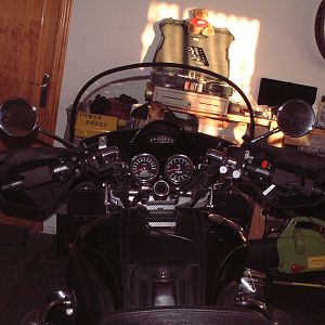

No idea, I have not fitted them to my bike, need to refer to the photos, but I think they would need to be removed even if you can hopefully leave all the cables attached. They do have a their own instrument mounting bracket to replace the stock one so the instruments are attached to the bars where they bend back. This bracket is welded on to the bars so will likely still contact the tank even if the pods are removed - see photo below which I think does not have the optional welded bracket and is using the stock instrument mounting point.
