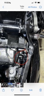

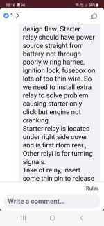

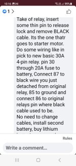

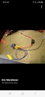

Went on a ride and turned bike off at a rest area. Went to leave turned on the key, gages sweep normal. But the headlights didn't come on. Depressed the clutch, in neutral, kill switch in start position, pressed starter button. Nothing. Turn signals, brake lights, horn all work. Gages reading normal but no low/high bean indicator. Push started it fine and drove home. Next day I pulled fuel tank, unplugged all connections and cleaned. Reinstalled. Pulled and cleaned the 3 relays on the left and swapped them around. Pulled and cleaned the 2 on the right. Replaced the 5 pin start relay. Old one worked. When the key is on, gages sweep and set. Hold in clutch. Hit starter button and hear clicking from starter relay. Let out clutch and it stops. Installed new battery. Pulled starter and installed new Toyota starter. Rebuilt the solenoid with new parts. Pulled all fuses, cleaned and reinstalled. Tested with meter. All work fine. Traced out harness best I could. No broke or loose wires. Bike dismantled all over shop floor. Spent hours reading threads till eyes crossed, headache. Bike starter still won't start. When I turn on key, hear fuel pump. Just won't start with the button. I've run out of ideas. And low on patience.
2008 rocket 3 roadster
Anyone have any ideas? Thanks, jimmy
