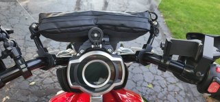

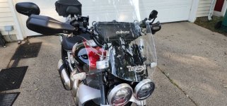

This is my setup and design. I found it works quite well. A lot of trial an error getting the lowers to look just right as well as neet and tidy. Looking at the bike in real life you can hardly even notice them. Tweaking the windshield can give you a pretty fair pocket without making things ugly. The Powerbronze hand guards are shown in an added picture as well as how I mounted my handlebar bag to make it work. There us a lot of activity on my handlebars..a cell phone mount, Beeline Moto mount as well as a Gopro Mount. Maybe I'm getting a little carried away...then again only I have to look at it so who cares.

My experience with handlebar mounted screens in the past would have the screens getting pushed down onto the gas tank at speed. Did you find an exception or additional support?
I assume you're referring to mine? Yes, I made a small bracket that runs under the stock screen mount. The whole thing this is very sturdy. Have ridden fast and in high winds. Bike moves before the screen does.
