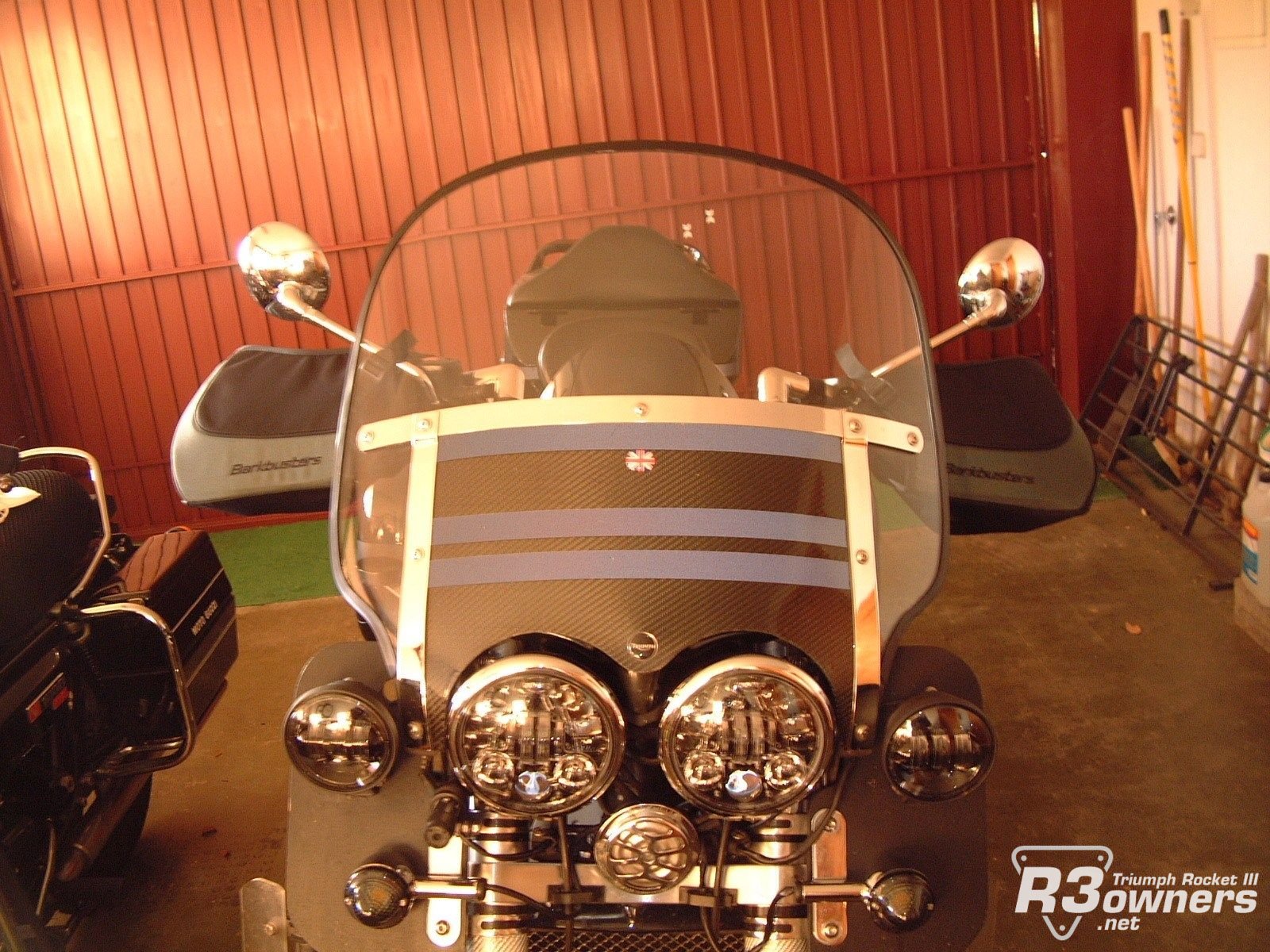

I was tempted to purchase the Triumph Fog lamp kit but was not happy with the performance and price. Instead I purchase 2 of these MCX25 LED MOTORCYCLE DRIVING SPOT LIGHT from Stedi and couldn't be happier. Alloy housing, great looking, waterproof connectors, good mounts and excellent light output. These are the 25 watt spot lights which project a long way down the road. Stedi has multiple mounting options for these. I fitted them to the Triumph Fixing Kit with longer bolts going through a home made bushing painted black. This was to get the lights outside the windshield to stop glare. Ran them all last summer. The 2 spots put out more lights than top rated halogens in the old reflectors. Have them hooked up to the high beam circuit. Very pleased with the performance and especially the price.
These are not Chinese knockoffs but top quality Aussi goods!!! Well done mates....
