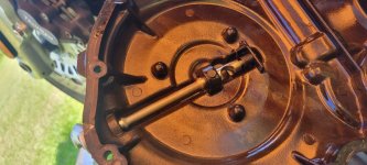

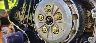

Yeah when you offer the front engine cover into place, you have to have the lifter shaft already turned anti clockwise so the spring is hooked and primed, and then turn the lifter shaft anti clockwise the final bit as it goes under the head of the lifter piece/pullrod, so the 'claw' on the lifter shaft hooks in around the back of the lifter piece / pull rod's head.
The spring keeps the claw from sitting against the back of the head when lever is out.
I am pretty sure I had it grabbed correctly when I put the cover back on. But, I will head out after this bit of school work and pop it back off and try again.
There is no way that the clutch lever should be that easy to pull in. The springs of the clutch are strong. They require much more effort than that to lift the clutch pressure plate up to release the clutch.
I too think that the fork of the lifter shaft has come disconnected from the lifter piece, that or the top of the lifter piece (the button part) has broken off the end. That happened to me.
Ok, I went back out and unbolted the cover, looked at everything again, and it was all good. I double-checked that I hooked the lifter this time, and it now works. Guess I'm a little out of practice. It still clunks at idle but once it speeds up a bit it almost stops completely. Its still there though so Im a bit nervous on how long it will last.

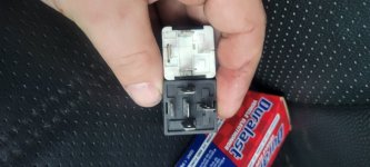

I hit up the local part store to find a relay that I could use to replace the the one that is dead and the other two that will need to be replaced. I will break off the center plug and cover it and use it as a standard relay to see what happens.
