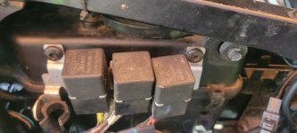

Well, I got home and started playing with the bike. I tried to start it, and it continued to turn over without firing. When I turned the bike on, I realized the fuel pump wasn't priming. So I swapped out the relays, and it worked fine, so I will be getting new relays tomorrow after work.
