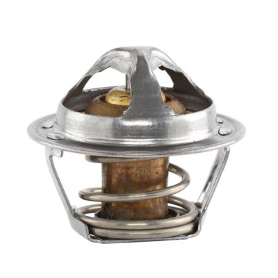

There is an Aussie High Performance one that fits and increases flow suited for modified engines.
@Kevin frazier got one last year.
Check with him but it did requre a little file work I think.
Tridon is a world wide auto parts supplier and if you Google you may find it locally too.
If you cannot find one I'll send you one but it will be about the same US$25 price as the item itself to post to USA.
Tridon Thermostat (High Flow) TT2003-180
This seller ships to Australia and NZ.
It fit fine ish, no issues, opens at 165f I believe, i got 10 miles🥲out of it. But im gonna buy another, it helps, but NOTHING helps like a time consuming tune. Like days worth, then temp is no issue, ever.
