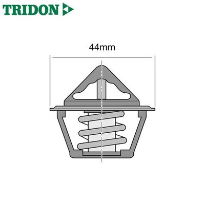

The std offset triumph thermostat (TOP) vs Tridon TT2003-180 Hi-Flo offering.
Obvious size difference - should work well in our summer heat.
Hi John. Just found this thread and you seem to have the knowhow about the Thermo. I too am trying to lower the running temp on my R3 classic. Can I ask is the new thermo you fitted a straight swap with no machiing to make it fit? You say you used the 82C Tridon Hi-Flo Thermostat PN: TT2003-180. is this a straight swap for the Triumph original? Or is some work needed to make the new one fit? How do I get thermo off without removing oil tank which seems to be in the way, and the oil pipe that is in the way too that runs across it. I have tried to remove thermo but can't seem to get an angle swivel joint in on bolts to loosen them. What is that clever tip you have to do this?

But do not forget the head modification required to fit.
A little work needed to fit the HI-Flo Thermostat - a before and after shot.
