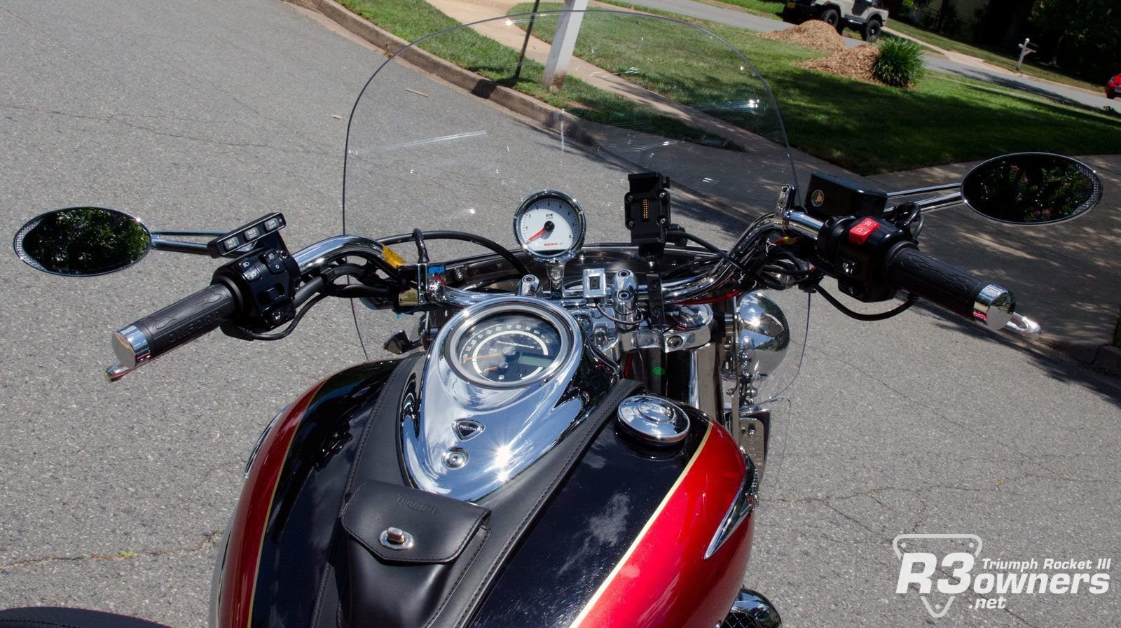

Need a different mount of the Touring. ...
Looking at pic of your bike Paul, how about right on top of your McCruise Controller?
You could potentially also make a bracket to mount off your GPS Ram Mount (the lower part, the clamp) - something like the one I made, but with hole at one end and mounted off the upper bolt and angled slightly inward (maybe 20-30 deg)
It could even go right on the face of the Brake Reservoir (if you don't mind losing the view of the level window)
Also see my mount in the opening post - something similar for yours, but instead of centered on the bar clamp, offset to the left
Or a bar-mount option - I posted some pics in this thread of mount types that would be easily modified to use on a bar
