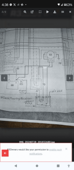

Hello, my name is Allen and I own a R3 for a long time (07), Since I've got it I had the click problem and I'm use to it, so far, but now I want to fix it. Problem that I have is that I moved to Spain from the States and, here, this bikes are not common. Can you please write me back with step by step moves? I want to use Google translate for my mechanic. Thank you and I hope to hear from you soon....
This pic is what you are trying to do. See post number 3 in this thread posted by me. That is the closest thing to a step by step I have seen. That's what I used to fix mine. It's not hard to do.
