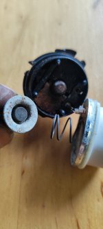

Today i check relay ,and is oxid , i Will change relay 😎
