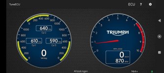

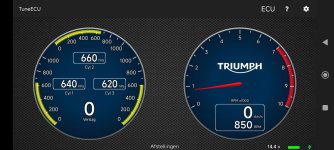

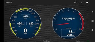

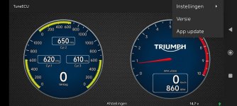

Hello guy's.
Yesterday i was riding and the bike had a bad idle and vibrations under load again, also had a smell of gas on stationair.
I connected it to ecutune and found out different readings on the throttle bodies.
I have some readings attached here. Could that be the reason for my symptoms? And you think te let it adjust make a difference?
Best regards Martin.

I think that i need the dealer to do that, i read that its not that easy. Or can you send me in the right direction to do that with some tips?
Do i need special tools besides tuneecu?
