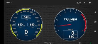

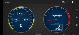

Today i tried do do the balancing myself, quite a hassle with the air plenum, but sorted it out. First sprayed al the springs with wd40 and cleaned the trouble body with egr cleaner. Then started balancing
I was working for 610 hpa but could not get that, whatever i tried. My new readings attached. The bike idles much better now and runs a lot smoother. Stil have a little decel popping but not to much i guess.
What you guys think, should i leave it this way or could the dealer make it anny better?
By the way, i reinstalled the original 20367 before the balancing.
Best regards. Martin
Looks good, I’ve always used a 20368 not 7 maps? You are probably real close now to being back right, good fuel, good fuel filter, you should be good to ride like you stole it. Gonna leave r-111-r video here for future reference.
