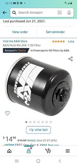

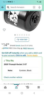

You have correct part number on oil filter you used and sure it fits under cover and right size? My local shop was not sure and recommended me to buy from dealer and didn’t be stupid to start oil change and stack without correct filter on halfway down the road! So I will be appreciated if you tell me part# please!!
I am sure there are others but I like this one cause easy on off.
So K&N 204-1 Work for sure you did install it and that bolt in end did not interfere with nothing under cover? You did install in on your bike?? This type I was always using on my Harley that welded nut did filter change 5 minutes deal! With regular Tools don’t need to remove bottom bolts to stick strap oil wrench and make space for movement!! I bought already wrench for oil filter dealer style ;)
Yup, fits perfect and like you said wrench makes it easy. Don't mind higher price than others.
I would not say is more expensive than original from dealer same 17$ a pice On eBay !! Thx appreciate for for tip on oil filter and cold start trick tomorrow definitely try it!
