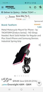

I don't have the charging head (yet?), but it will also work without that in the mix. Which one do you have- wireless?
My direction...
