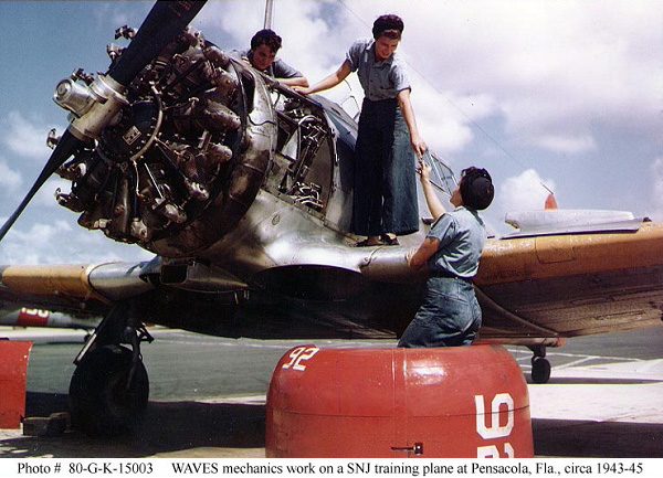

all of them P&W from beech 18 , dc-3, dc-4 , (dc-6 , my favorite R2350)) and believe it B-25 that picture of an at-6 trainer shows what looks like a P&W single row don't remember the code but same as what is on the famous beaver pulling 450 bhp at T/O power. my avatar dc-4 retardant bomber flying and bombing a fire in the nwt canada

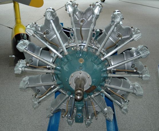

There is a primal feel -- sadly seems to only appeal to men -- from the deep throated sound of power, be it those beautiful radials, standing close to a steam engine first moving, our beloved Rockets . . .
Yea, that Picture has an R-1340 on the AT-6 - Back when I was a wee lad, I worked for a small, family owned business at the airport here in Tyler; Holland Aircraft Engine Service. We built R-1340's, 985 Wasp & sometimes Lycoming Radial's. Most of our business was from the R-1340's & 985's for the Agriculture pilots who still used them on the AG Cat's & Air Tractor's from crop dusting the large cotton fields. Also did quite a few R-1340's for a bunch of the guys that have the AT-6's that they refurbish for "toys" (and we think we have an expensive hobby). We had quite a few of the T6's flying in the air shows up in Oshkosh & the air races out in Reno.
I know every part, nut, & bolt of those Pratt & Whitney's! Started off as a parts inspector, magnafluxing all parts to check for cracks, measuring the parts for tolerances to be re-used or replaced & then the last several years I was there I got to build the beasts! I assembled every part of the engine assembly except for the Blower (supercharger) - The "old man" always got to do that :cool:
Anyway, I could talk for days about all the processes we did at that shop, but my favorite part was always when finished building them they put them on a test stand & ran em off slowly through all of the RPM ranges for about 3 hours (I'm hard of hearing now... Duh)
