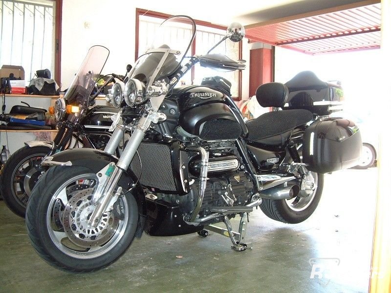

Edited to add. As RamAir have said - in half jest - that they intend to pop to Spain when Stage 2 is done - and do the test fit on the Bike they measured up (mine) - It's maybe something I can try and bring up with them. maybe they can reduce the rear pot height a bit. Again - Colin and I designed Stage1 by eye. Colin modelled based on having first modelled 3 K&N's in 3D.
He also did this filter - which is un-f*cking-believabley LOUD. It out roars the THUGS exhausts and wind roar, and that's at 100mph.
full
