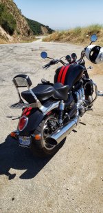

That is my exact setup and it's close, but not perfect. I still end up with bilateral hip pain after a couple hours on the Day Long, but that may be due to old age more than anything. BTW, I'm 6'6" and 260 pounds.

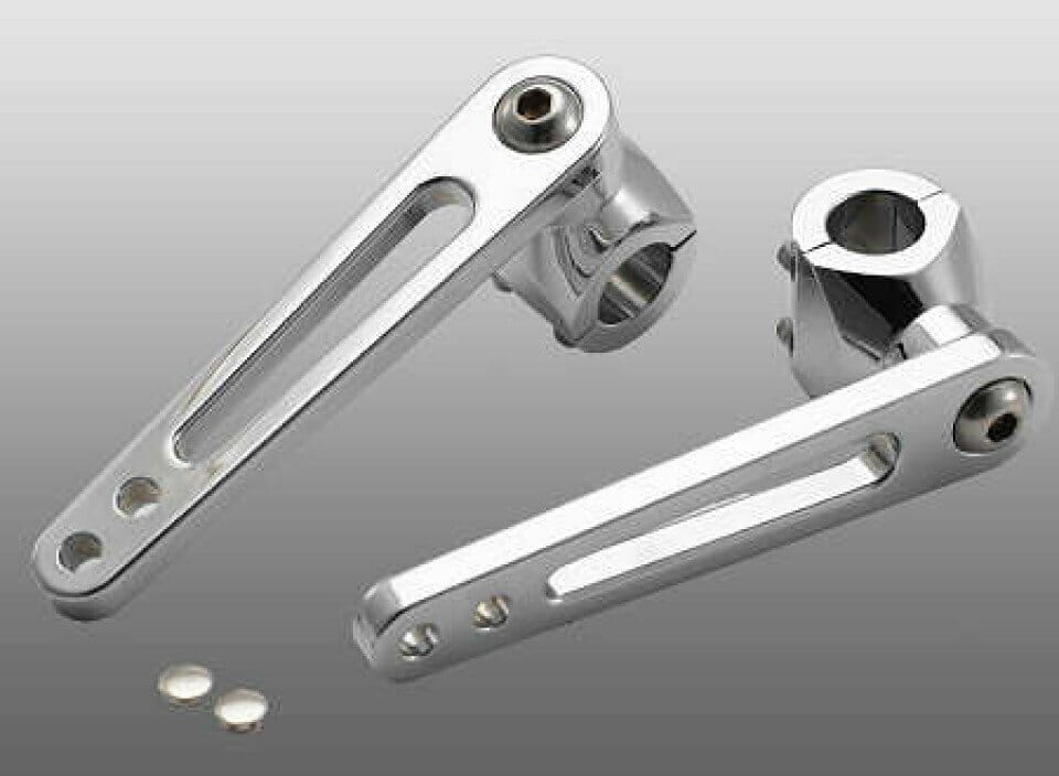

Well you have the pinnacle of seats so just foot position and joint angles to adjust or have options for. Try an extra set of short h'way pegs attached to your foot rails with 1" clamps. Lots of versions available on eBay under $100. RIVCO Honda GL1800 ones fit perfectly and excellent quality.
