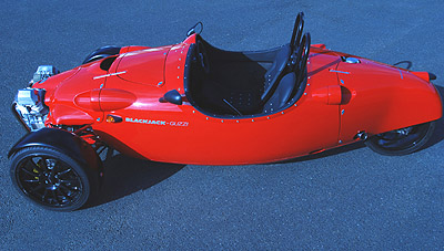

I have never been able to grasp the need for 3 wheels on a car though!!
I'm fine with that concept - IF - the two wheels are at the the front.
Sadly KitCars here are **** close to impossible to register.
I had a mate back in "days of yore" who was iirc secretary of the Bond Bug OC. Scarred me for life.
