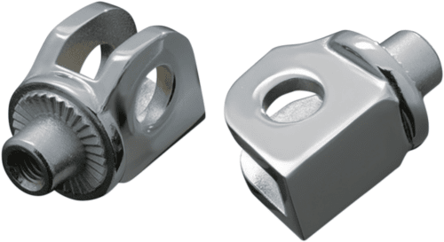

Kuryakyn - 8808 - Front Splined Peg Mount - Suzuki
@Ishrub , thanks for the tips. Since those are all cross compatible with the Rocket III, I suspect they are all around 24mm wide at the mounting end and too wide for the 21mm mount of the 2020+ Rocket 3. So I am trying to see if there are other brands that have a 20mm or smaller mount.
This may help (not the parts but the fitments) as the front tapered adaptors for Rocket III peg mounts are the same as the descriptions of other peg fitments for other makes/models below. This will expand your option list a lot but the actual foot lever angles and placements are another point to consider and not assured as the Triumph factory option footboards that @1olbull has fitted. I would experiment with 'cheap as chip's EMGO branded generic ones for about US$40 a pair, just to check
Kuryakyn Holdings Front & Rear Tapered Footpeg Mounts - Chrome. Fits Triumph.

    • Kuryakyn footpegs are a 2-Part System.
    • Select the correct adapter for your bike followed by your choice of Kuryakyn foot pegs.
    • Serrated adapters for a secure attachment.
    • Adjustable angle.
    • Sold as a Pair.
    • Proudly Made by Kuryakyn !
  • Adjustable angle
  • Sold as a Pair
