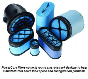

Ive been wondering if one of these Donaldson Power Core filters could be incorporated into ram air system for a rocket.
These filters are supposed to offer superior filtration but in a reduced size to OEM filters.
