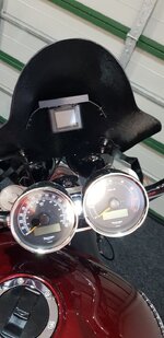

I used one of these for temp, volts & even dose mph or kmph. Just plugs into you obd (ecu) plug under your seat.
Works great 👌🚀😎
