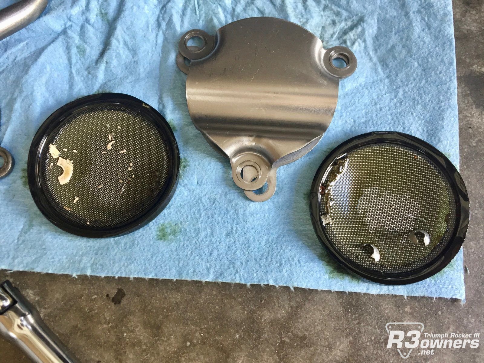

I know it's common, but hate seeing these parts in the screens… recognize anything I should be concerned about?
