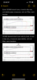

im struggling to find the correct one on tune ecu. net myself, i will look on my laptops and see if i have the one im talking about. Which Nels 20368 is in your ecu now? I believe there are 3 Nels 20368 tunes, the original nels, claviger did a Nels 20368 and the Nels 20368 by Bob R. I asked our @Bob R before about it thinking it was his tune but I believe he said not his but maybe knew the tune. Ill keep looking Dyno 20368 stock tune, d and d slip ons, cat delete pipe crossover, ram air filter, oem header
20368 derestricted tune nels by bob, d and d slip ons, crossover pipe delete, ram air filter, oem headers
