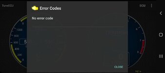

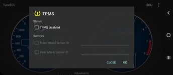

Sorry to bump up this thread again, I have same problem with my 2021 R3 GT with the TMPS Light on dash. My model wheels has no TPMS sensors equipped.
Bought Tune Ecu app, clicked TMPS disabled, TPMS light still remains on dash, no disappear.
Tune ECU shows no any error for TMPS.
Any advise woul d be very appreciated...
