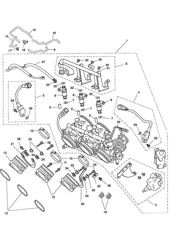

You need to replace the Primary TPS - It's the one at the back of the throttle body
#2 - PART #T1245113 $137.04

so this is what i need to take off and clean right, and then when i put it back i'll have to turn it to get the right idle?
Yes correct. The torx screw holds it in the ‘correct’ position along the adjustment range..
