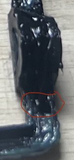

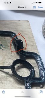

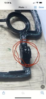

Forrest did you fix leak? The chrome tops seal much better and easier, the black tops are smooth machined surfaced, the chrome are channelled like surface, how i did this one, from starting with all clean parts it took 2 hours, on a bike that pulled into garage, its a long job, to get disassembled, cleaned, prepped and ready then back together, i only use three bond on archs like manual says and i lubricate seal and towers for spark plug wires, archs got threebond, grease along all other edges this time after cleaning with brake clean for a must stick, I normally put three bond on head archs directly, but trying new things, greased gasket upto threebond edges. Bolt washers got grease, threads got oil.
